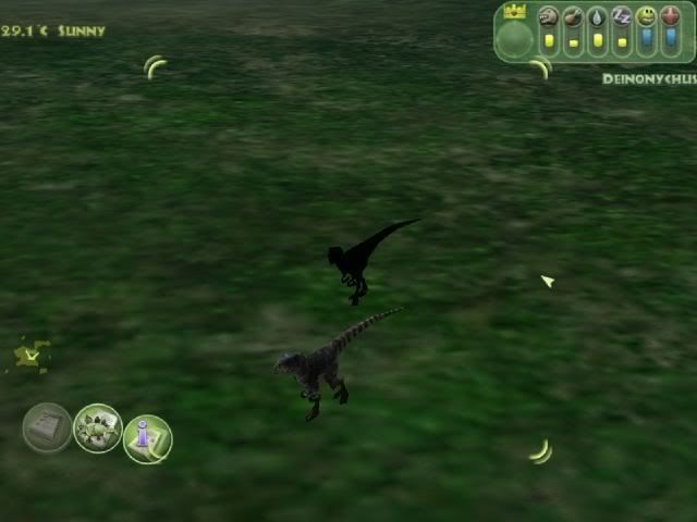

As you can see, my cloned dino (a Deinonychus) comes out with a completely black skin, whereas the other dinos from the dinos_flamingcliffs.tml came out fine (Raptor in the foreground works correctly).

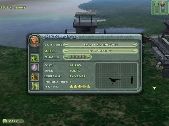

The same is evident within the hatchery.

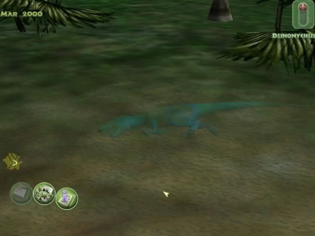

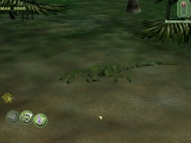

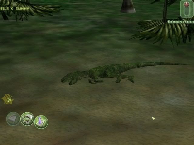

However, upon its death, the Deino's skin slowly fades to a partially-translucent dark-green skin.
Interestingly, the skin then flashes a whacky blue-ish colour, slowly fading away until it disappears.
